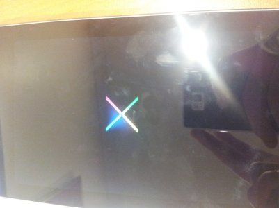

Hi all. I was wondering whether anyone could help me.
I recently got my Nexus 7's screen replaced and I got it back in the mail yesterday. Everything was normal. Asus had reset the device so I had to install all of my apps/nova etc..
This morning I woke up, and booted up the device after it being shut down the previous night. The device loads the google logo screen, then moves onto the colored 'x'. The 'x' will do it's cycle of colors but will then freeze after about 10 seconds. And then the device will reboot. This seems to be an endless loop and the only way I am able to stop it, is by going into the boot loader and force shutting it down.
I hope someone here is able to tell me what I can do to sort this out. Even some kind of factory reset that works I would be greatful of. If no solutions here work, I am probably going to have to send it back to Asus again.
**edit: The picture is of the exact point that the 'x' logo freezes and restarts.
Thanks in advance

Unfortunately after trying these steps, it still doesn't want to work properly. Thankyou for your assistance though. Looks like they've sent me a faulty device.

Thanks for your help. I really appreciate it. I decided to just wipe all the data and reboot. That seemed to fix the issue. I'm wondering whether some of the non market apps I had installed gave me a virus of some kind.
