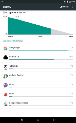

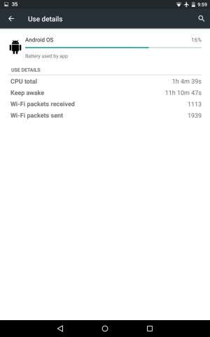

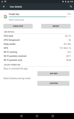

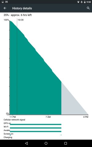

Could anyone give an explanation for this? Not the first time it's happening.

Looks like your Google app has run amok. I assume you've tried rebooting? Weird battery/app behavior is hard to pin down after just one cycle. You'll need to watch what it does over a day or two (after rebooting) to see if you can figure out a pattern.
Also your device shows it was awake the entire time.
So theres an app causing it to not sleep properly.
Id clear system cache and test again. If that fails a hard reset might be in order.

Ya, rebooting brought everything back to normal, I was just curious why it happens once every so often.
