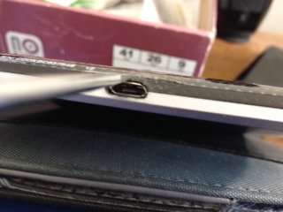

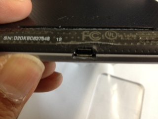

I have faced loose charging/connection problem, and I had to hold it down with pressure to push the plug downwards to make it charge.
I think either my kids tried to push a charger plug in wrong side or it fell down, but the net result was the pins inside the nexus port is slightly leaning towards back side of nexus and also the back cover itself near the port has came out of the latching to the tablet bottom side.
Note:
(1) Do it at our risk.
(2) Apply small pressures and plan to do it multiple times rather trying to do all at once.
(3) Do not put screw driver or any hard item inside the power port metal frame as you may damage the pins.

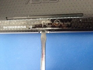

Use a screw driver and slightly put in between back cover and top of power port (top of metal frame covering the pins). Gently start pressing down little using your finger. Test now if cable plug fits snugly and test it is charging. Do this several times with small increments at a time. Once completed, I have noticed that not only charger plug stays stable in the port and loose connection gone, back cover also now latches to the tablet bottom side frame without a gap.

Thanks much for this info. Unlike many people, I've had my N7 for two years and just began having trouble. Didn't drop it, didn't pull the cord or any of that stuff. Never had to replace the battery. The connection just seems to be loose. Used your suggestion and a tiny screwdriver to bend the port slightly. It fully charged for the first time in a week.

I've just started having the same problem---tried 5 different USB-to-micro cables (3 of them brand new) with little to no success besides the "bend it like Beckham" method --- will try to recenter the port once (or if) I can get it charged up to at least 90% (right now, I have a pen under the USB end of my Nexus 7, seems to be charging), but hope your fix gives me a more "mobile" solution - I mean really, a tablet that only charges when it's standing still? Kind of defeats the purpose of a tablet in the first place !
Thanks for the photos, just tried it, mine is charging normally again---only took about 2 min., now Ijust have to test it with my external battery, but that shouldn't be an issue now that the port is "fixed"
