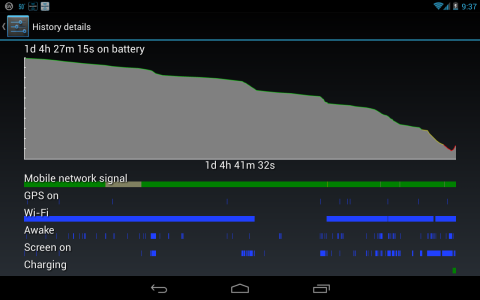

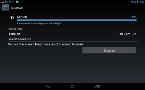

I usually get five hours screen time. Today I got almost 4.5 hours by watching a few videos, Netflix for about 20 minutes, XM Radio app on for several hours both with screen on and off, and a few phone calls (Yes, I made some calls) here and there and some other apps. I think that's great with the screen on as much I have had it on. You can see when I put it on the charger.
Brightness is the culprit, I get 6h screen time but my brightness is nowhere near 60%, I find the dimmed screen is easier on my old eyes.
