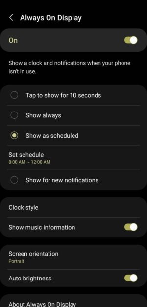

Yes , under lockscreen >tap.AOD >toggle show for new notification see if that helps Screenshot_20211215-173043_AlwaysOnDisplay.jpg

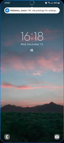

That does make the AOD display turn on but not the banner notification. How can you attach a picture to a reply? I got a screenshot of an email coming through that shows the banner and edge lighting but I cannot figure out how to put a picture in here.

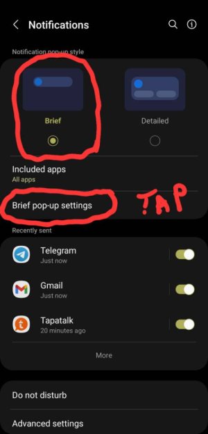

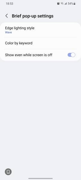

Also go to settings>notification>brief pop up select>brief pop settings tap>edge notification change by tapping , follow my screenshotScreenshot_20211215-184912_Settings.jpg

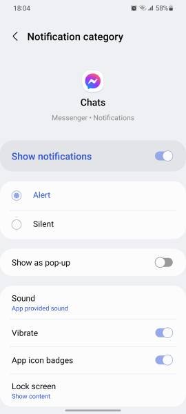

The first image is what the pop-up looks like (obviously with the screen off). I followed your instructions to the brief pop up settings and this is all I have in there. The third picture is what I was explaining in my original post; the show as pop-up switch keeps turning itself off and I keep having to go and turn it on.

Yeah. There is the option to turn on pop ups on lock screen, like I showed for messenger on the first post, but it turns off automatically a few hours after I turn it back on.
Hmm strange it will revert back to off after some time , do you want try something? Go to settings>apps>3 dots upper right corner tap>reset app preference
I did the reset and when I checked the setting the show as pop up was turned on already, so hopefully it stays! I will update in the morning.
