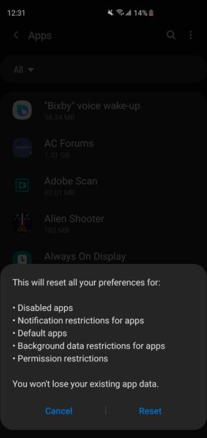

After b.diddy suggestion, try going into settings reset app preference see if that helps .Screenshot_20190728-003154_Settings.jpeg
