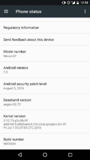

Has everyone else received their security patches? I've just checked and I've not had an update since 5th august on my 6P. Any ideas?
Thanks, but the reboot didn't work. It's strange that's it's 2 months out, I'll flash it and see how it goes. Cheers
I'm still on August security update. Not rooted or nothing like that. Any thoughts why I haven't received security updates? To get nougat i enrolled in developer preview, got it then unenrolled.

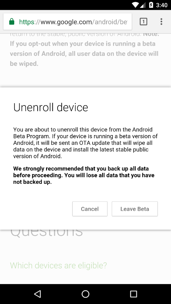

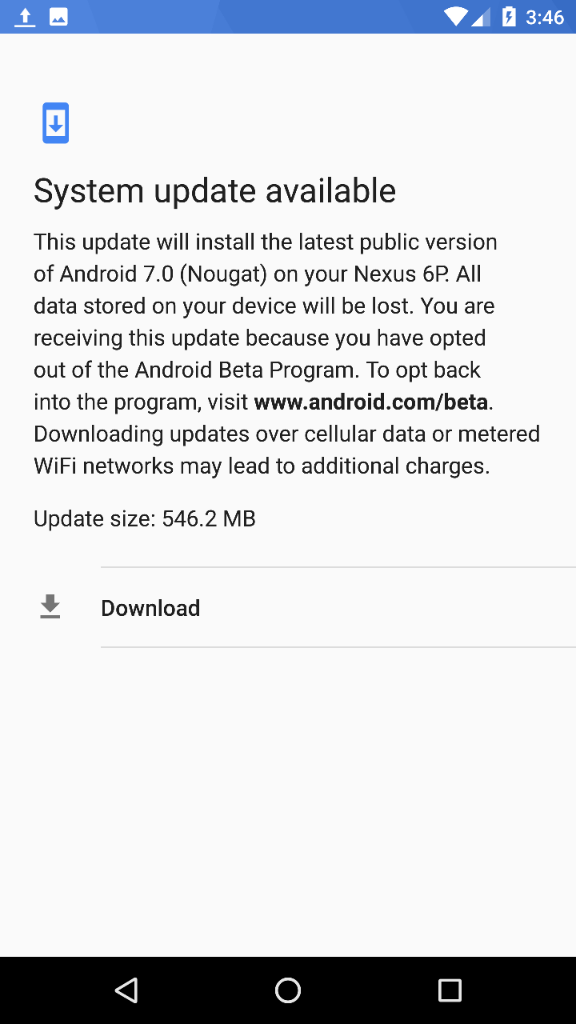

Well it's a good thing you haven't tried it. Because I had nothing better to do (and, frankly, because I don't trust support in matters like this) I went ahead and unenrolled from the 7.1.1 Developer Preview (after making a current backup of course). I was immediately presented with
(uh oh - that doesn't sound good) and after the unenroll was completed I received
At this point my device hadn't been wiped, so I suppose I could have just ignored the system update but I went ahead and accepted it and of course it wiped my device and rolled it back to 7.0 (NBD90X).
Oh well - now you know not to trust anything I post.
