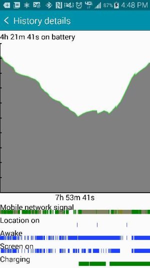

My note 4 is charging very slow. Is anyone else having that problem? My fast charge didn't even kick in. Told me it would take over 3 hours to charge and I was at 55. I'm at 88% and it's saying it's going to take 53 minutes. This just started.

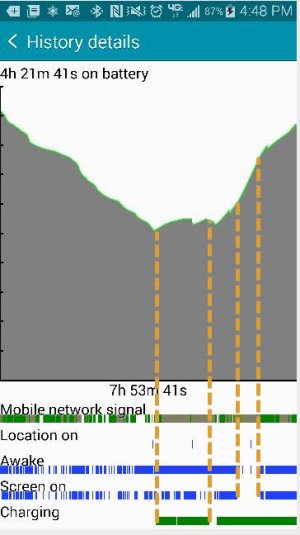

I only quickly glanced at the posts up to this point but I have a feeling people are chiming in without really looking at the battery graph that you posted . . .
Draw some lines up from the bars below to the upper graph and you can see some things . . .
1. In general your device is AWAKE most of the time. That's bad for battery . . . period . .
2. Your screen is on a lot during charging . . why is that?
3. When the screen is off during charging the charging rate is high (see the part between the 3rd and 4th yellow dashed lines I drew?).
4. Your mobile signal while charging is low in strength which will impact power consumption, PARTICULARLY if youre using the device while charging and you're not on wifi.
If the image you posted isn't typical of what's general use for you then ignore this post but taken at face value I think what needs to be addressed is the fact that for maximum charge speed one should reduce load on the battery while charging. If not . . then heat will be a factor and charging speed may be reduced to protect the battery from overheating.

For the most part that is typical use. Charging had never been an issue even when I was using the phone. What's really crazy is that it now seems as if my battery is lasting longer than normal except when it goes 20%then I can watch it drain
