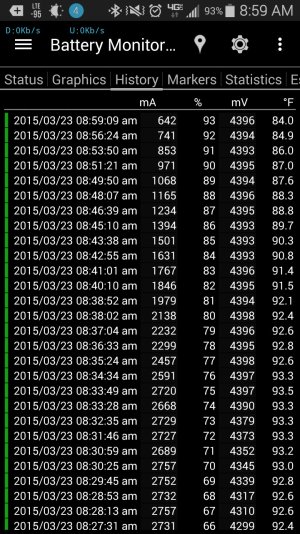

i find fast charging only helps if you're below 20% it's slow charging when it's higher
My Verizon Samsung Galaxy Note 4 does adaptive fast charging up until about 75%, then it starts to taper
