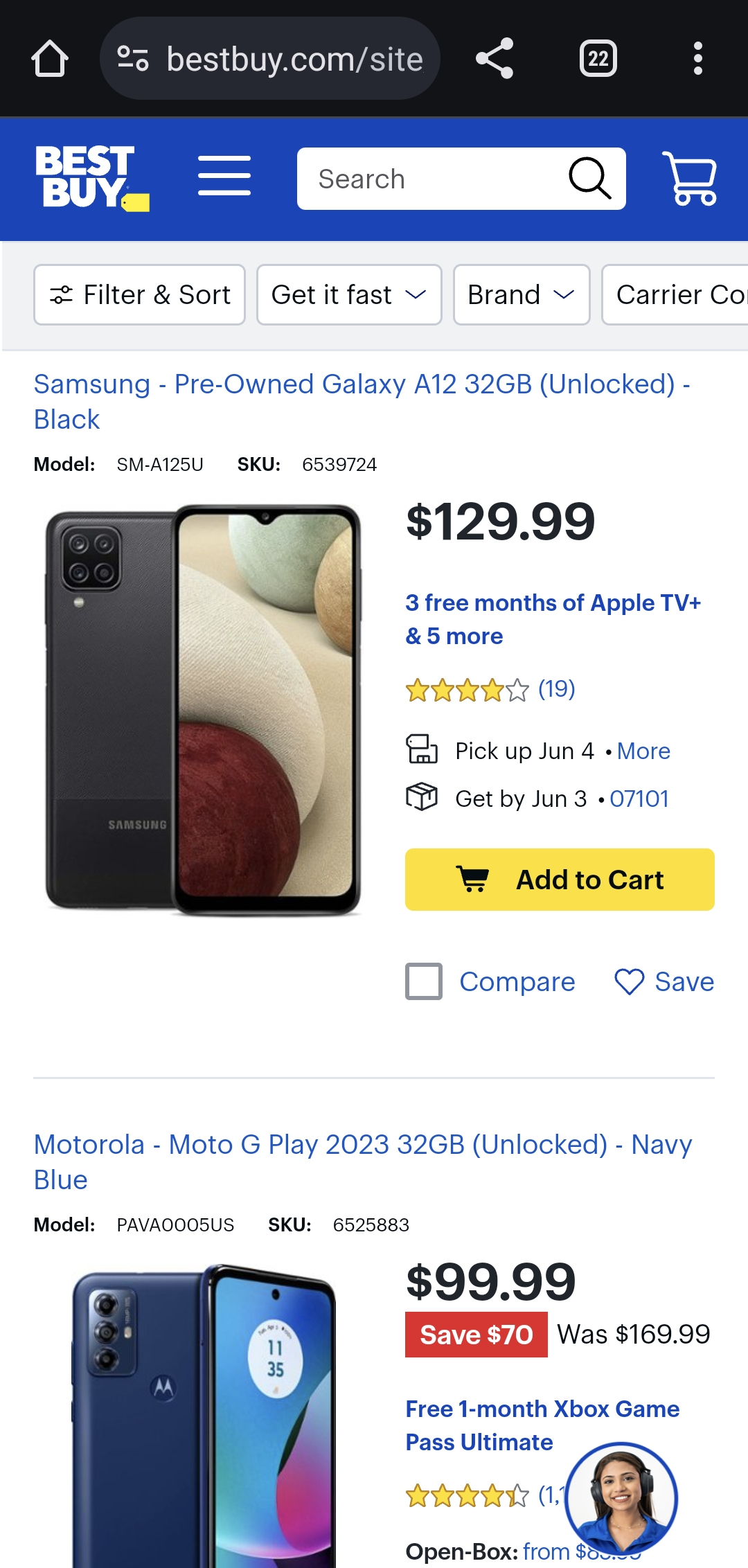

Really? Is there any unlocked phone cheaper than 50 USD? Mind you, "backup" does not nessacarly mean "a phone which will run all the apps you use daily". It can simpley mean "a phone which can still make phone calls, and is compatible with your network".
Oh, that. Yes, securty is a concern.
Oh yeah you can definitely get phones cheap, Best buy /online you can even get flip phone probably 50.00
