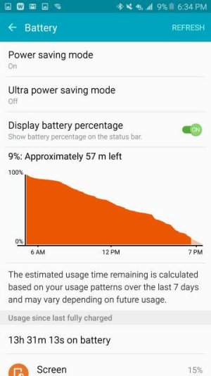

I had a great day today fellas with my battery life. I normally was getting 7 hours on average before coming to this forum. Today I got 14 hours.
So I have my phone in power saver moder
I got rid of Facebook part of my fast
I was busy at work so I did not hit it as heavy as I have in the past. Today is my normal operation mode.
I took snap shots of all the monitors and will post them a little later.

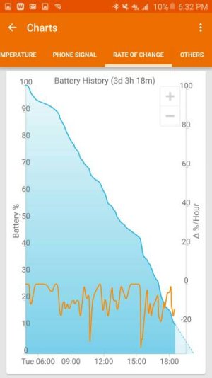

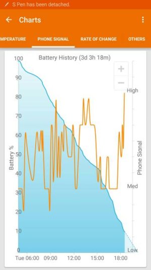

One thing I did notice that was interesting. My phone Signal as it spiked was a direct mirror opposite for the battery drain under rate of change. I have ATT have have poor signal at work and at home and I think that this is a major reason of my battery situation. ATT used to work really well in both areas but over the last year or so I noticed it has really dropped off a bit and now seems to be the new norm.
Phone signal - look how the rate of change is almost directly the opposite of the signal chart showing a major cause of bat drain.

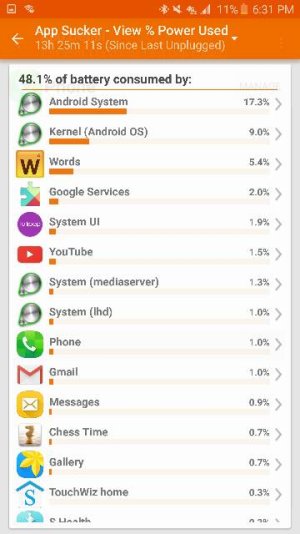

Here is my app use. I got little over 3hrs of Display on as well. Again, took off Facebook, in power saver mode, moderate use, with my gear 2 Bluetooth ed the while day. Actually the Bluetooth did not account for hardly any drain on my battery it registered to 0% among all the others.
