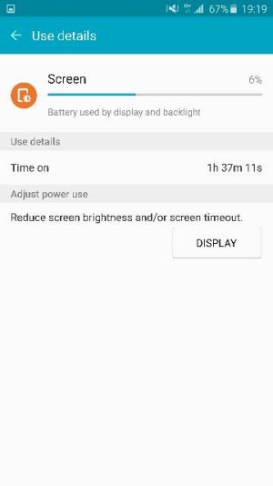

Im calling BS on Gsam battery pro. It shows screen on 2h 45 mins when i know for a fact its less than 2 hours. My batery screen on time under settings is 1 hour 25 mins. Where does gsam get this information?
My GSam Battery Pro SOT matches my phone SOT. Make sure your "since time" tapping the triangle at the bottom, shows "since last full charge".

No its a total nonsense it shows double screen time. Now at 5 hours. I set it to show since i last unplugged it thats when it was 100%. If i set since last full charge it shows almost 7 hours SOT. Look at screens taken at the samw time. Anyone knows what is going on?

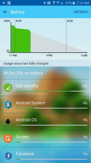

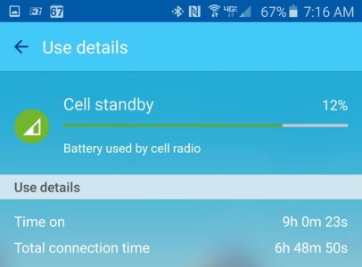

Standby drain seems to be fix. I have installed most of my apps at this point. I'm using that Doze app and it seems to be working wonders. I don't know why cell standby still shows connection time of almost 7 hours during a 9 hour period
No, something on the preferences are not correct or you need to clear the data and cache and start over we the GSam, but it needs ro match your phone.
You turned off advanced calling and did a cache wipe after getting everything installed again?
Your signal is very low, that will eat your battery and could have to do with the stand by.

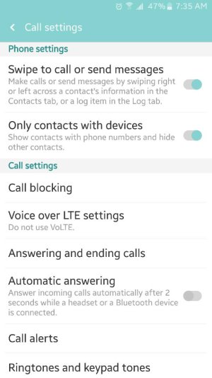

Where do I find the VoLTE setting? I did change from Global to LTE/CDMA if that makes a difference.
Really dont want another facotry reset. Got all the settings and apps installed. Batelly life is okay just over 4 hours sot on full charge
Tap on your dialer, choose more, top right, should be here. I think Verizon calls it Advanced Calling and I think AT&T calls it VoLTE.
