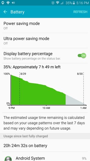

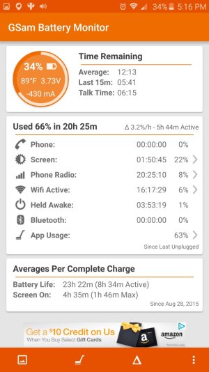

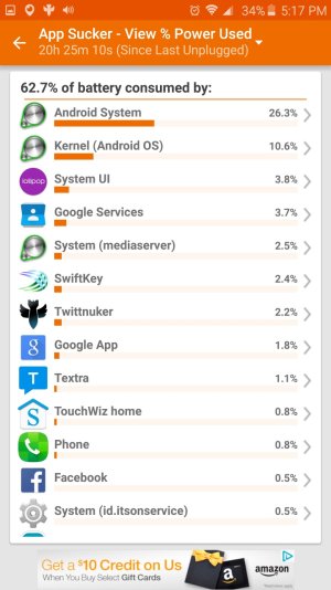

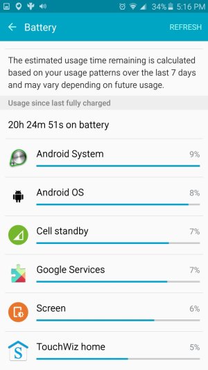

Got the phone Thursday night. Been tweaking and setting it up. Took it off the charger last night at around 9pm my time and had somewhat normal use outside from not streaming Spotify or At Bat while driving like I usually do. I think I'm on the right track with things. I don't have too much on-screen time with normal but I'd like to go from getting 1:45 or so to about 3 or 4 like you guys are getting. I still think it seems relatively healthy and hopefully it settles in nicely.
Any problem areas stand out to you guys? Let me know if I should tweak anything. I have location on wifi network only or whatever that setting is and Google Now on. I slept from 3am to about 10am too and my battery drained like 5% or something. I'm on wifi at home but just regular mobile network while I was out last night and just a bit today.

Got the phone Thursday night. Been tweaking and setting it up. Took it off the charger last night at around 9pm my time and had somewhat normal use outside from streaming Spotify or At Bat while driving. I think I'm on the right track with things. I don't have too much on-screen time with normal but I'd like to go from getting 1:45 or so to about 3 or 4 like you guys are getting. I still think it seems relatively healthy and hopefully it settles in nicely.

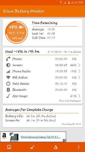

Really dont want another facotry reset. Got all the settings and apps installed. Batelly life is okay just over 4 hours sot on full charge
Just wanted to try to help you. You don't have to do a factory reset. You can reset the gsam stuff in the gsam app. Makes it kind of start over. I'm not sure where it is without looking but it's in there. You could also probably just uninstall it and reinstall .

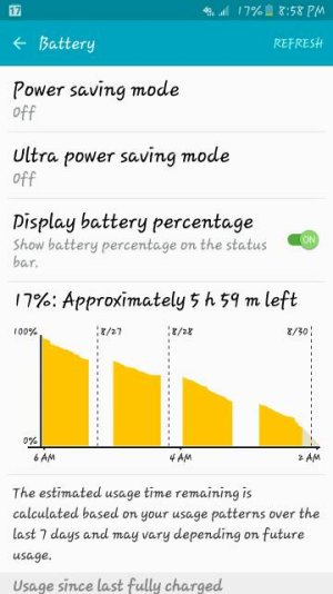

Very light use over 4 days, but looks like standby time is crazy. 62 hrs with 3 1/2 hrs sot.
Location off, I sync mail myself, and a few other tweaks in this thread.

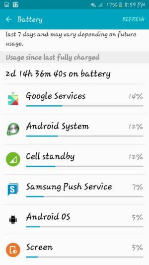

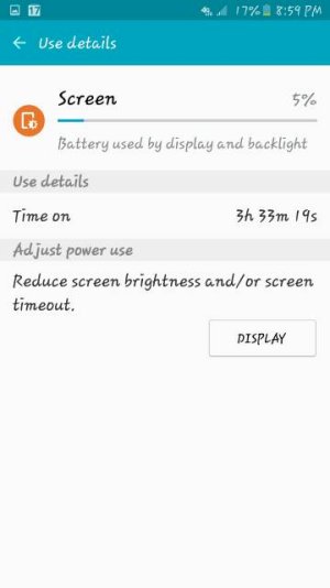

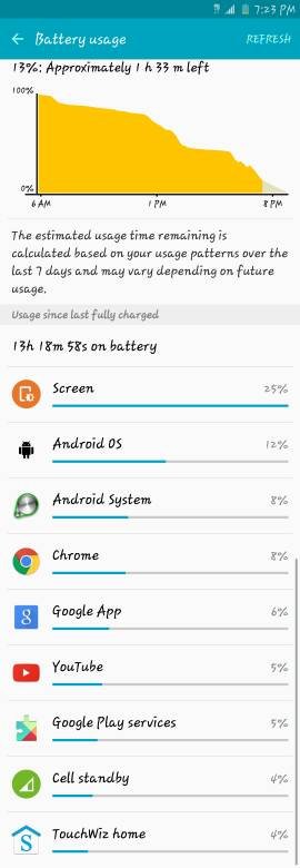

I have had my phone disconnected since 5:53 am pacífic time,and it is now 6:23 pm do these seem like good battery stats?
I have used it fairly, but not as heavy as when I'm at work.

This is what I get it is now at 13% and has been disconnected since 5:53AM Pacific Time and it is now 7:26PM with pretty good use.

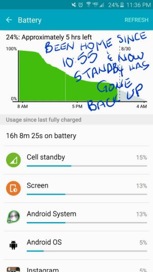

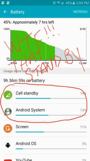

Does Wi-Fi affect standby? Honest question cause I was home from the time I took the phone off the charger at 7:15ish am and was on Wi-Fi till I left the house at 4:45 to officiate a high school football game. Met my crew around 5 with 14% standby time. From 4:45 to 11 my phone has been on 4G. Here are some screen shots. I took a screen shot at halftime.

WiFi usually improves standby if you have poor cell signal. But cell stand by is a known issue in Android that Google hasn't fixed yet. Apparently carries over for some other phones, although I've never personally experienced it on my Note 4

Reading your issue immediately reminded me of a couple of things, like the Wifi always scanning option, WiFi calling and even the WiFi frequency you may be using, some reported (including me) that when using 5 Ghz connection there was unusual drain and when 2.4ghz was used there wasn't. So as you can see I'd suggest to take a look at that thread and see, but I know that there are a couple of things that may help you and others with this and other battery issues.

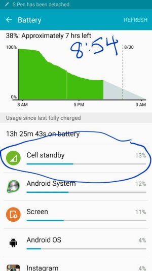

Yeah I can't seem to get rid of cell standby I even am using doze now and can't get it to go away.
For those getting cell standby battery drain, the first thing to do is disable voice over lte. It has a different name on different carriers so google it but can you can usually get to it in dialer settings. The next is to disable WiFi calling if its available. Those are two things that always cause it and are bugs Google has to fix. Weak signal is the other.

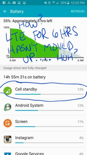

I disabled it and I see no option for WIFI calling(I have verizon).

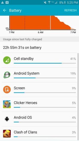

I think that I have 5 days left(out of the 14 to return it), and I'd like to ask a few questions.
1). Having a weak signal obviously interferes with cell standby and my signal is poor. However, does turning off 4g negate that issue? As you can see in the above photo, I turned off mobile data and cell standby was still draining my battery.
2). Do you think it's the phone that is messed up or a software issue? I see other people post here and they don't have that issue at all. Should I exchange my phone?
BTW, the red on that graph isn't an indicator regarding my connection. It's red because my battery was at 8%
