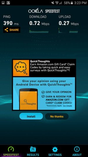

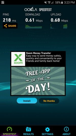

I did two speed tests under the 4g network.
Could this be what is affecting my cell standby? It didn't affect the battery on the GS4 but my signal is pretty terrible.
Regardless, I am going to go to the verizon store tomorrow and I'll either order a new phone or see if I can test out a signal booster

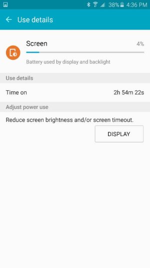

Something I noticed. Cell Standby is third on battery usage at 10% Is that normal? All day I've had a steady signal but mostly 3G since I'm on border of 4g.
But when I clicked on on it standby was 10 37 min which is where my battery unplugged is at right now.
2nd on that is Time without Signal which was 0. I take it that is good.
The 3rd item though says Total Connection Time 2 hours 38 min but I don't get that part. Does that mean that's what data was used by my cell because I have WiFi on all the time and it's a strong signal. I don't have VOIP and I didn't get any calls today or call anyone. What would that be?

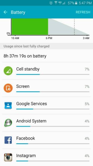

Still don't understand why instagram is showing up on my battery usage when I haven't opened the app today. Again my standby still sucks
Because Facebook does a lot of crap that phone manufacturers let them get away with.
Do you use Instagram at all?

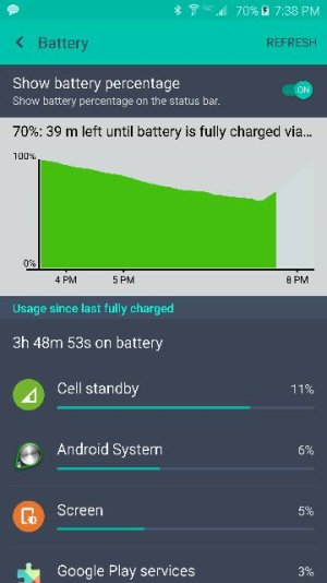

So yeah the battery life with the Note 5 is not bad but it could be better if Samsung fixes the Cell Standby issue
