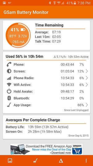

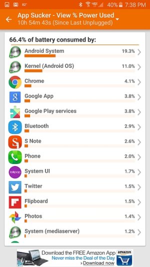

Your "held awake" time is almost the same as your total time since last unplugged. The battery drain seems to be coming through your apps though... something (or multiple somethings) you have installed is (1) keeping your phone awake and (2) draining battery by the app running...
thanks....any idea how to find out what?
That's some nice screen on time I would like to know if your using power saving mode,Facebook, YouTube,instagram? Oh and what's your brightness set at?
I'll post some suggestions later on down in this comment. I can tell you that I am getting over 16 hours total battery life on average, with over seven hours of screen on time. In a lot of ways, your battery data and mine are not that different - similar data for phone, wifi active, bluetooth, etc. Your screen seems to eat a little more than mine per hour (brightness?) and your apps eat a LOT more battery by percentage than mine. Your held awake battery percentage is low (2%) but your held awake time is looooong. My held awake is always at 0% and its usually held awake about 15% of the total on time. Yours is held awake, like 80-90% of the total on time.... which I don't understand at all.
All of that is why I think some app you are using, which is not itself a huge battery hog, is querying some android system process and holding your phone awake when it is not in use.
I would start by disabling or uninstall any bloatware or apps that appear on your battery list that you never use. I always suggest that because if you aren't using them its a no harm no foul effect on your user experience.
Second, I would open your phone up cold after its been sitting not being used for a while, and open up the usage manager, and check what apps are running, if any. If an app is causing wakelocks, it has to be running at least a process..... There are also apps you can download to find a wake lock causing application. Wakelock detector is the one I see mentioned but I have never bothered with it because my battery life is pretty good.
One last suggestion would be to try one of the battery saver modes and see how it effects your battery life and/or performance.

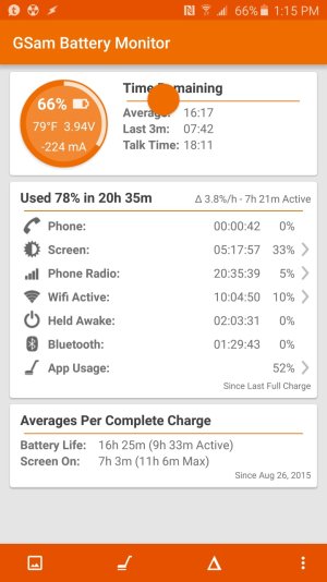

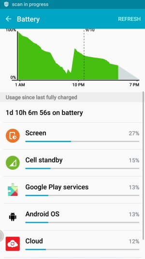

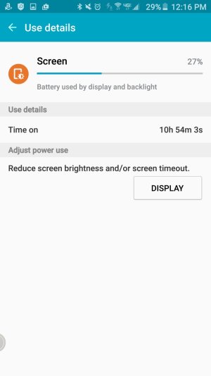

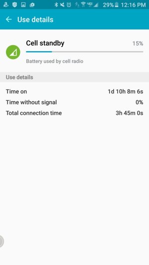

There is my GSAM report. I'm averaging 16 1/2 hours per complete charge, over 7 hours screen on time, and very little "held awake" time compared to my total hours since last full charge.
