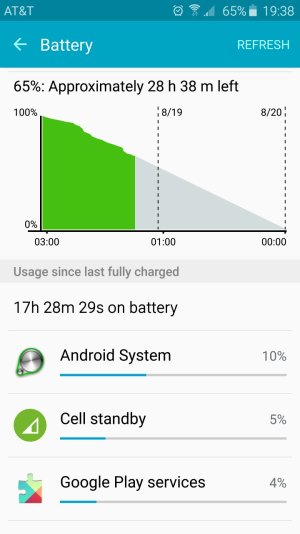

AT&T did. I have posted it all over the S6 Edge boards. the stage fright fix (if thats what it was) nearly doubled my battery life. Screenshot_2015-08-18-19-38-44.jpg
at 65% 17 hours off charger. key things, cell standby has been fixed ( and android sys )
