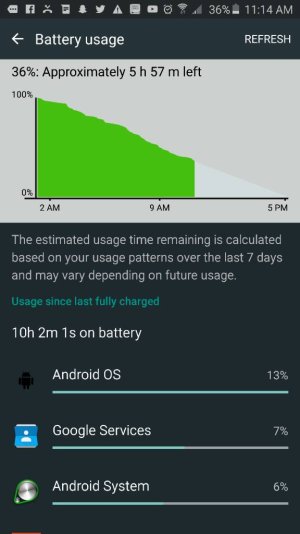

Getting less than 12 hours of batter life. Is this normal?
Could be depending on what you were doing. Could even be very good battery life.

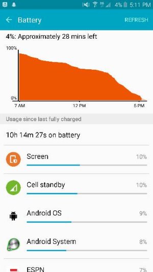

Hey guys,
The update for my Note 5 has given me a problem. I noticed faster battery drain due to "Cell Standby" taking up 20% of my overall battery and it was first on the chart underneath the battery stats. Can you guys please tell me how to get rid of this issue? I already turned off VoLTE
