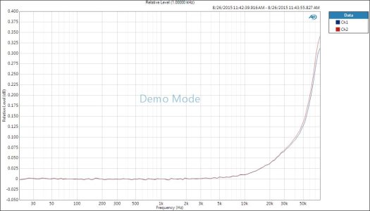

Hi guys,
Some hardcore audiophile data here. Measured the output of the Note 5 using AudioPrecision APx525. Some interesting facts and graphs below.
Simply put: it's an audiophile's dream!
  • Supports high resolution playback up to 192 kHz. Also FLAC by the way.
  • Extremely flat frequency response: <0.03 dB delta upto 20 kHz, <0.35 dB delta upto 96 kHz
  • Very good dynamic range: 98 dB at max output level, 120dB at default output level
  • Relatively low output level: -8dBV into a 16 Ohm load (for reference, Asian iPhone 6 = -1 dBV)
  • Output impedance: 4.6 Ohm. May lead to coloration if you have a headphone with strong impedance swings.
NOTE: all measurements done into a 16 Ohm load (standard headphone impedance).
Graphs
Relative output level in dB

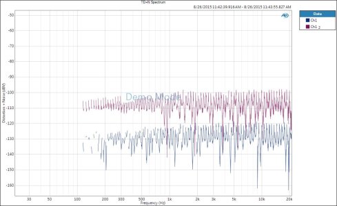

THD+N spectrum
