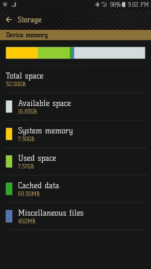

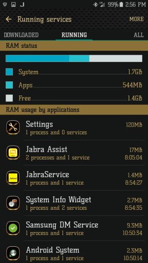

Check to see if your free ram is where its suppose to be and stop any apps that are self starting and not performing any function (on stand-by)
Also check to make sure your cache isn't overloaded......if your good on these then there are downloaded apps probably causing your lags.

Still as fast as the day I bought it, but I do maintenance on it. Every 2-3 days I reboot and once a week I clear the cache in recovery.

I suggest you uninstall Easy Cache Cleaner in the long run it might slow your phone down , all i do is clean cache in settings /Storage/Cached Data , and that's it and once or twice a month i go into recovery clean cache there that's all you need!

These apps are counter productive and sometimes interfere with your phones way of dealing with RAM, processes, and cache data. Delete all of that garbage. There are 2 simple ways to clear cache data on your phone already from stock.
