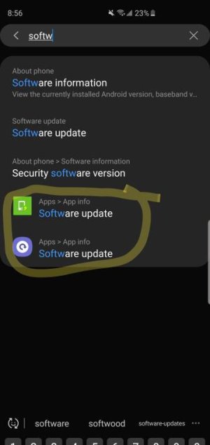

Check in settings >search bar type software app should pop up 2 clear data and cache in both then force stop
