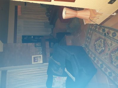

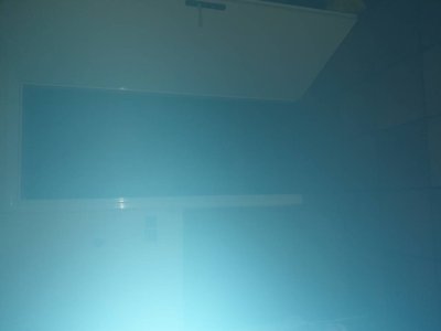

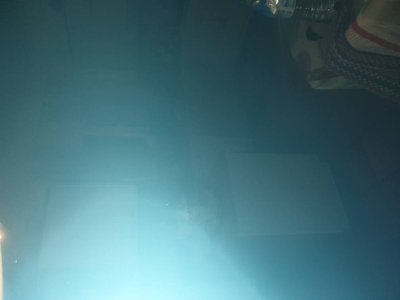

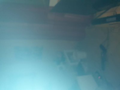

Note 9: blue tint appears in my pictures while using flash during night!! Any solution pls??!

Good evening everybody. I have a Note 9 for the last 2 months. I almost never used flash in my pictures but i did it yesterday.I noticed a blue tint in the side of the pictures!! Its dissapointing as hell!! I factory reseted the phone but the problem stills there!! Any solution?? Recently updeated to Android Pie by the way.....
