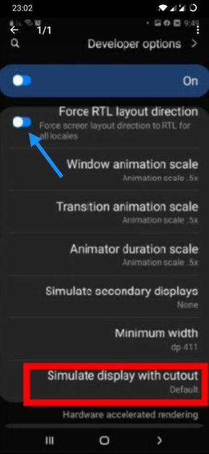

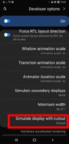

I solved the problem. I fiddled with the Developer Option/"Simulate display with cutout" by changing it from Default to Tall cutout, and "BOOM" the button gesture hint appeared and then select the Navigation buttons. I have reset it back to Default. But the problem is the alignment is to the right instead of left. How do I change the alignment to left.
Update : Alignment solved. When I fiddled with the "Simulate display with cutout" somehow it set the "Force RTL layout direction" to on. Turning it off and everything back to normal.

I solved the problem. I fiddled with the Developer Option/"Simulate display with cutout" by changing it from Default to Tall cutout, and "BOOM" the button gesture hint appeared and select the Navigation buttons. I have reset it back to Default. But the problem is the alignment is to the right instead of left. How do I change the alignment to left.
The alignment to the right is caused by this option. Switch it off.

Yes I played around with Developer Option. I may have touched the "Simulate display with cutout". Strange the setting was at default when the Navigation buttons disappeared. I did set reset to default and also turn of Developer Option earlier but it didn't resolve the issue. Was thinking of doing a factory reset tonight if no other solution. By chance, came across the Simulate display with cutout today. My thought was ya why not cut the top and not the bottom and toggle form Default to Tall cutout and it works. Strange, the problem wasn't the Default setting as I reset the cutout to default and everything still works.
