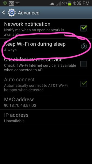

There is also a sleep or not sleep option setting in "Wi-Fi" then "advanced".
Sent from my AWESOME Note 2
Thank you. I recently had to do a master reset per request from ATT customer service and remembered I did something like this when I got my phone. I could not remember exactly what it was but this was it. It helped my wifi problems considerably. This was regarding dialing for the menu to turn off power saving on wifi.
