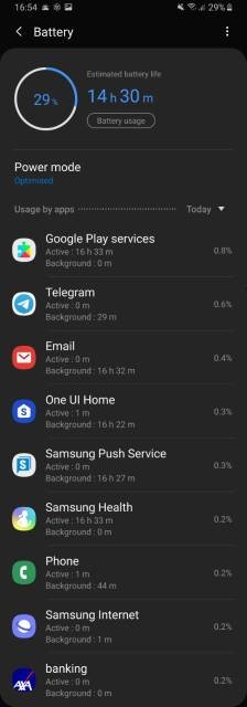

after numerous resets have Installed no app run it in safe mode and have not reset from backup. all is ok for 2 or 3 days then bam ....battery drain begins again ,
Your first screenshot shows optimize power mode not medium?
And your 2nd screenshot shows 2 days battery at same percentage ? Don't see battery life issue there .
totdat i been running optimised as i need to sync Samsung calendar .reel problems start as when I start to use the phone for anything ,I get around 3 hours sot even on wifi.

When Cell Standby is high, that often means poor cell signal, which can drain the battery. Does it drain like that if you're in a primarily strong cell signal area, or if you turn Airplane Mode on and just use wi-fi?
Cell standby is always high yet I have good coverage
Have you confirmed the coverage? It can help to use GSam Battery Monitor to track the cell signal strength throughout the day. You might be surprised at the result -- the cell signal bars don't always tell the whole story.

Do you still get that kind of battery drain in Airplane Mode? Ok to turn wi-fi on while in Airplane Mode -- I'm just wondering what happens if you turn the cell radio off.
Is the Cell Standby usage still high in Airplane Mode? That would suggest that something's wrong with the firmware or hardware.
