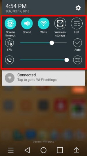

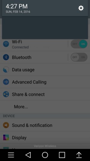

I am also using LG G2 but on version 5.0.2 and get the black/blank missing notification panel. This happens about once a day lately. The only 2 apps installed in the last few months were Google Keep and Textra SMS. I agree with the previous user's mom... it does come back after shut down and turn back on. But it's crazy having to do that every day. Any updates to the fix?
This is what shows up after reboot.
