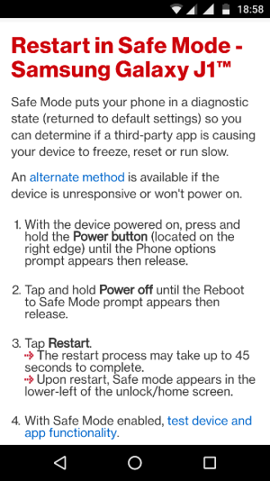

How is booting in safe mode done?
Can it harm my device in any way?
I have deinstalled all my firewall apps and the CM Security and the CM Clean Master apps, but still the same.
So far.
Those Verizon links usually get modified by the forum software for some odd reason. Clicking on it still takes you to the correct site.
Safe Mode will not affect your personal data in any way. All it does is temporarily disable your 3rd party apps that you installed, thus helping you narrow down a problem as being caused by something you installed or something that was preinstalled (or the system itself).
