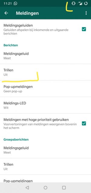

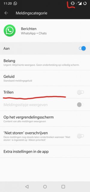

I did also turn it off in the Android notification settings itself. I noticed this setting mirrors the settings in whatsapp itself. So turning off vibrate in Android notification setting will also turn vibrate off in whatsapp settings. I attached two screen shots. One of the Android notification settings and one of the whatsapp notifications settings. It's in dutch but I highlighted the vibrate settings which are turned off.
So in my situation vibration is turned off in Android notification settings and whatsapp itself, but still the phone vibrates!
Can someone confirm this is working on his/her phone and if so pls tell what phone and android version you're using.
