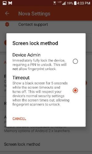

As far as I can't tell, fingerprint is disabled by Nova when double tap is enabled
Buy the full version if you enjoy using it.... basic free version is going to always purposely give you troubles...
So I believe I've found the issue. Nova tries to set the timeout temporarily to 5 seconds when you double tap to lock. But the V20 doesn't support 5 seconds. 15 seconds is the smallest in the settings.

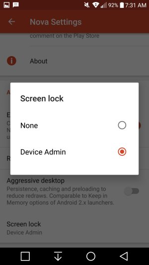

How do you get to the screen lock method box in Nova Settings? I went through each setting and was unable to find it.
Thank you.

Has the inability to use the fingerprint after double tapping to sleep been corrected?
Never mind. See there is a Nova workaround now...
