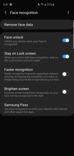

So strange, does your face unlocke look like this?Screenshot_20190428-174115_Settings.jpeg

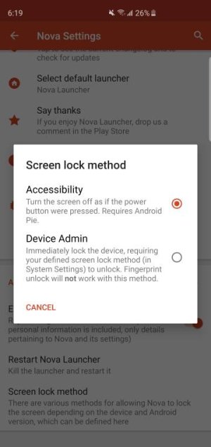

I think I might of found it
in nova settings all the way to bottom >advance > how nova locks choose device admin instead of accessibility.
Just tried that and it works, but then you have to unlock your phone with your pattern instead of biometrics. I'm wondering if it is some bug, because the accessibility option in nova says the lock gesture should act like the power button, but locking my phone with the power button works correctly while the gesture doesn't
