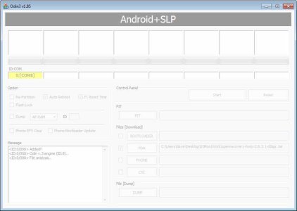

I tried 1.85 and got the same results. Here's a screenshot from the 1.85 attempt at the time of failure. odin_185_screenshot.jpg
That's all I've tried. I don't mind trying other things but it seems like I'm putting my phone at some risk every time I do this so I would like to make intelligent choices about what I try to flash ( or at least not make bad choices :) )

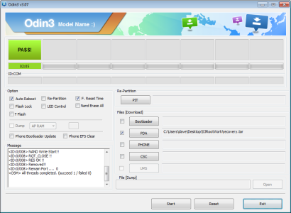

It worked! Thanks!
For the record, here's what I did:
cp recovery-clockwork-touch-6.0.4.3-d2spr.img recovery.img
tar -H ustar -c recovery.img > recovery.tar
  • Used odin 3.07 to flash the recovery.tar file ( see attached screenshot )
I used the touch version of clockworkmod because I saw that someone else had a similar problem and was able to make things work using the touch version: [Q] Odin 1.85 -- Crashing when hitting "Start" (trying to root 4.0.4) - xda-developers ( but I don't know if that mattered or not ).
The img to tar conversion technique came from here: Clockwork Mod Recovery - Odin Flashable

Thanks again!
