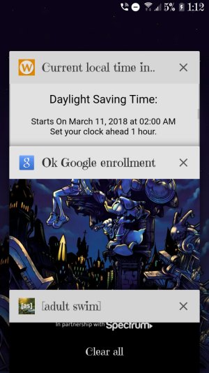

This question was asked once before by someone else and it went nowhere. So here's the situation.
I cought ok Google enrollment on my multitasking thing and it's been happening since I factory reset. I have an HTC u11 "life" with the edge sense USA veriant, and this issue first happened maybe two weeks ago.
I've disabled ok Google detection and I've even tried to disable verious Google related apps in the settings. I don't even know what ok Google enrollment is and I've not been able to find anything out about it anywhere. I hope by posting this, any one else experiencing this same issue would benefit from it as well.
The issue is, my screen flashes white and has the same animation of if you switch apps super fast. In a fraction of a second. J happened to catch it twice and I even took a screenshot of the app in question. It has my home screen in the app image with "ok Google enrollment" in the banner with the standard blue of the Google app.
It's really annoying and I can't do anything tasking, or generally anything. Most notably it's in chrome or YouTube, Infact it happens again typing out this sentence.
If there's anything else you need from me I'll do my best to update you on this increasingly annoying issue...

I had the voice recognition thing on from the start until maybe 5 or 6 weeks ago, idk sometime at the beginning of last month, when I some how got an AdSense virus or something, where ads would randomly pop up whenever I would tap in the screen or leave it sitting idle, even when my phone was locked. So I factory reset and it was fine for 2 weeks, and I suddenly started getting these random ok Google enrollment flashes the beginning of this month...
Oh and it so happens if I'm in multitasking mode, where two apps are open, the pop-up will still happen but will be tossed into the app switch/multitasking menu.
Is it possible that it might be related to the ad thing?
I took that on the 23rd, it's exactly the same whenever it pops up, depending on what app I'm using while or whatever I'm doing. The thumbnail of the app is the same as the screen on whatever it is. One time I was watching TV on my spectrum app, which doesn't let me take screenshots of, but even that "captures" it, I won't be able to replicate it as it happens absolutely randomly and the spectrum app doesn't support spit app mode.. which is the best way I can catch the enrollment app, as it pops up "this app may not support split app mode" or something like that
Aha, that's helpful to see. That makes me suspect it's some kind of adware or browser popup ad. You're correct, that "g" logo is really outdated, so it's highly unlikely an official Google app would still be using it. [see later post for correction]

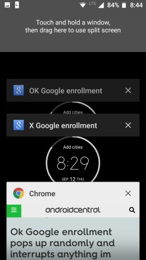

Hmm, so it looks like I was completely wrong earlier. "Ok Google Enrollment" is in fact a legitimate system app -- I just looked at my Pixel 2 XL, and it's there, along with the oddly out-of-date "g" logo. To find it on your phone, go to Settings>Apps​, tap Menu>Show System, and then look for it. Now select it and tap Disable, and see if that helps.

So this phone is a Motorola z2 play. And this problem doesn't interfere with the operation or other apps but concerned me. THANK-YOU SO MUCH for figuring out that it is ligit. Totally makes me relax about it!
I too signed up just so I could say thanks. ;)
For some reason, I can't tap on disable only "force stop" :/
