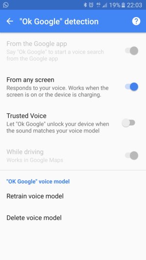

I didn't think there was a difference in the two apart from the edge features. Here's what I see
It doesn't make sense that retrain voice model would be there and not trusted voice. I mean, what would be the point?
Just wondering out loud: is it possible that you have to enable SmartLock before the Trusted Voice option appears?
My S7 doesn't have SmartLock. It must be an Edge setting.
Smart lock is under settings/ Lock screen and security/ Secure lock settings on mine. I don't have it enabled on mine so I doubt this is the cause of trusted voice not showing.

I don't have that setting/option.
Edit.
OK, I have found Smart Lock and Trusted Voice on my S7, however, it does not show unless Lock Screen is used/activated. I enlisted a four digit PIN and the setting suddenly appeared on the Lock Screen menu. With no security, the Smart Lock with trusted voice option is not listed.
Edit.
Yeah I assumed that some type of lock protection was being used, Trusted voice is used to bypass the lock screen.
