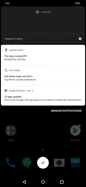

Hello, I just got the OnePlus 6T this morning, and have a weird issue. Originally, I had quick tiles in the notification shade, but now that entire area is blank. I don't believe I toggled any setting or anything.
Any idea what's going on?
Everything is turned on in the Icon Manager in the status bar settings

I tried toggling the theme with no luck as well. Currently resetting the phone so I'll report back in.
Factory reset did not fix the problem for me. I submitted a bug ticket to OnePlus, so hopefully I hear back soon.

Mine had the quick tiles visible for maybe the first minute or two, then they went away and haven't been back.

Just curious, did any of you with no issues have Android restore your apps on initial setup? The 3 times I tried that, I had issues. I just did a reset without restoring apps and now the quick tiles are available.
I am about to do another reset while trying to restore the apps again to see if it was a fluke
Did another factory reset and restored apps, and the problem is back again. The quick settings area is completely blank.

I want to add that I just tried ONLY restoring the google call history and passwords (I told it not to restore apps), and the problem still persists.
So it seems that any restoring of Google information on initial setup is causing the problem.
