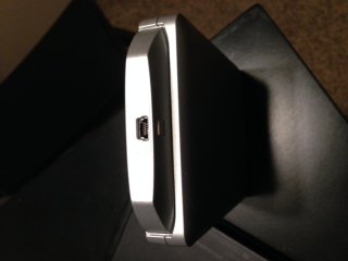

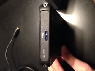

sorry if i am being confusing but if someone can help me with exactly which cable to purchase that can be used on the nexus with my external. i have one external the seagate and the port is mini usb to usb. i have another external taken from my macbook pro which i put in a external case and the hook up is a usb 3.0. here are some pics securedownload-1.jpegsecuredownload.jpeg
sorry if i am being confusing but if someone can help me with exactly which cable to purchase that can be used on the nexus with my external. i have one external the seagate and the port is mini usb to usb. i have another external taken from my macbook pro which i put in a external case and the hook up is a usb 3.0. here are some pics View attachment 102004View attachment 102005

You plug your external to just a regular otg cable and it works? i read that the nexus 7 doesn't power some external hard drives which i know probably will be the case in the externals i have. so I'm guessing people say to buy one with a y cable so you can plug the power into the micro usb female port while plugging the other port in the usb and using the other micro usb to plug into the nexus. I just dont know if it'll work for sure and read that sometimes hooking power can brick the device or something i read in one of the amazon comments. I don't know I'm pretty confused on what will work and don't want to keep ordering differing cables and parts and end up wasting money. I want to get it right the first time
I have 3 external Western Digital Passport drives - 2 500GB drives and 1 1 TB drive. I can use the 500GB drives with just the OTG cable and standard USB cable on my 2012 Nexus 7 without additional power to the drive. The 1 TB drive required power - it drew too much juice. On my 2013 Nexus 7, none of the drives worked without additional power to the drive and that's when I got the y-cables.

the only thing is one of my external has a mini usb to usb is there a y cable with mini usb? also you have to con nest a charger or battery pack with it as well correct? would it be better instead of buying y cable and otg separate or just buying a micro usb host cable with micro us power like this one
Amazon.com: Micro USB Host OTG Cable with Micro USB Power for Nexus 7 Galaxy S III & Galaxy Nexus: Electronics
Hard to tell what the connection setup would look like with that cable and a hard drive with a micro USB port on it. As for battery power for the drive, I certainly found that I needed it with my 2013 Nexus 7 and any of my My Passport drives.

well for the setup up with the cable link from amazon i think would be micro usb male plugged into the tablet, micro usb female will have a battery pack or charger plugged in, usb female will have any of the choice of external. do you think that will work?
oh i see why people buy the y cable and connect a otg to it like sparksd suggested. well I'm going to try and give it a shot
Yeah, it can sure seem to be a bit of a lashup but all I an say is that it works. To sum it up - the OTG cable connects the N7 to the Y-cable. The rest of the Y-cable is connected to the external battery power source and to the hard drive. The hard drive is then accessed on the N7 using the Nexus Media Importer app (a rooted device gives more options). And note that the external power supply is not also charging the N7 battery - it is only providing power to the drive. One other thing - sometimes there is sensitivity to what is attached when - i.e., connect all of the external pieces together first and then plug the OTG cable into the N7 - I have see it sometimes occur that if I attach the OTG cable to the N7 first, followed by attaching the rest to the OTG cable that Nexus Media Importer does not connect to the drive.
