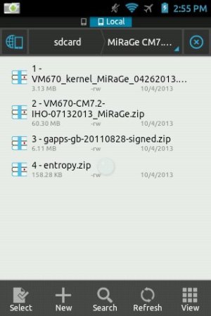

Step 1: Make sure you have a nandroid backup (first) and have moved everything from the SD card to the computer (after nandroid).
Step 2: Since you have the SD card backed up on your computer, you can now safely remove everything from it, leaving the SD card blank.
Step 3: Download this zip folder and extract it to your blank SD card. (it should be a folder with 5 zip folders in it, marked 0 through 4 - https://db.tt/b8MfKLNu
Step 4: While in Cannibal Open Touch Recovery, flash the 0 zip. This is ZenGarden Touch Recovery. After successfully flashing 0, reboot into recovery again. Now you should be using ZenGarden.
Step 5: While in ZenGarden, wipe everything out of your phone (except your SD card of course) including cache and dalvik.
Step 6: Flash the 1, 2, 3 and 4 zips in order. 2 should take the longest.
Step 7: After successfully flashing all 4, find the option to create a new SD card partition. Make the partition size at LEAST a gig and a half. I chose 3 gigs. Make swap = 0. Next choose "ext4" as type (important).
Step 8: After successfully partitioned, reboot your phone and wait for the phone to completely boot and start up.
