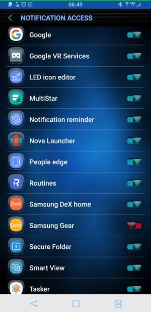

I currently have a Gear Fit2 Pro and a Gear Sport paired with this Note 9, successfully. The only issue is that when I switch watches the NOTIFICATION ACCESS for the GEAR WEARABLE app gets turned off. I get a notification and have to turn it back on. It's irritating, as Wear OS devices do not do this, but it's a minor inconvenience.

I wear a Gear Fit2 Pro to bed for sleep tracking. I turn the Fit2 Pro off and I get a notification on the phone, that looks like a Fit2 Pro, so I guess that watch is generating the notification.
When I turn on or pickup the Gear Sport and when I select notification, I am taken to the screen attached. I have to select the toggle and I'm off to work. Otherwise, the watch switch is on.
