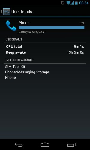

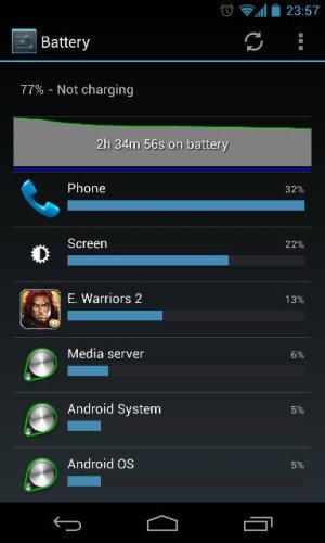

Anyone know why could this happen? I didnt make any calls at all.
Do us a favor: on that same screen as above, tap on "Phone" and let us see what the next screen shows.
There you go...
