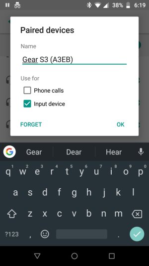

I have a Moto x4 running 8.0 with security updates. I was having the same issue however I didn't want to use an app or anything. My car is also a 2013 Camry. I went into Bluetooth setting clicked on the Setting for the device and deselected phone and it appears to have worked. I still receive texts as well.
