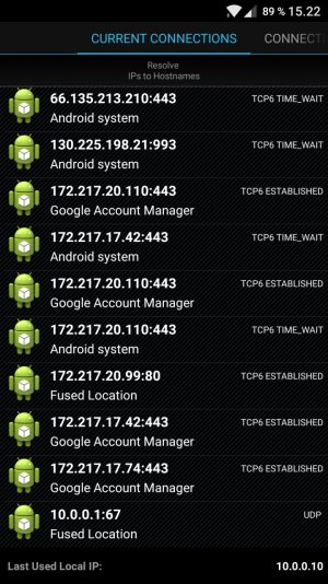

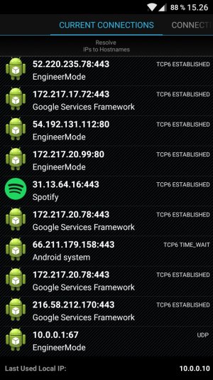

I have now installed an app that shows me which apps are accessing the network and which protocol they are using.
Every time I reboot the phone a NEW app is accessing the router gateway 10.0.0.1 using port 67. No other apps are accessing the gateway using UDP on port 67 (except youtube, when used).
And it doesn't stop - It's connected all the time.
Screenshot_20171230-152617.jpgScreenshot_20171230-152225.jpgScreenshot_20171230-145829.jpgScreenshot_20171230-200250.jpg
I think it's VERY weird that there's a NEW app accessing 10.0.0.1:67 every time I reboot. And it's also kind of weird that it keeps the connection open all the time.
