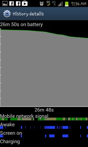

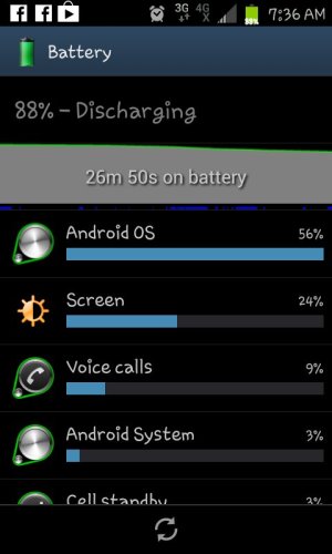

Using my new battery for a week now

Zantia, That looks much much better. I can't wait till my battery comes from amazon...I should be getting it any day now.

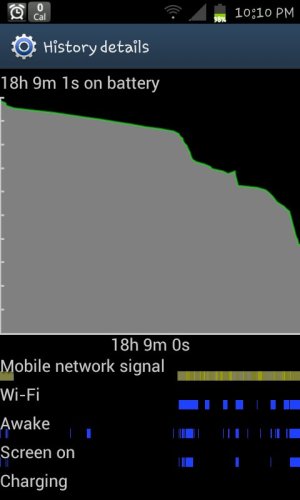

Adding some screen shots from this morning...

as a conclusion/next stage to this issue...
the manager at the sprint store acknowledged that the last few updates really caused havoc with the charging system for a lot of S2s. not all, but definitely enough. and they are issuing a fix at some point, only he has no idea when. he offered to do a hard reset for me, which may or may not fix the problem. hooray.
i told him that really wasn't going to work for me, and to make a long story short, the charging port somehow because wrecked in the process (why my phone won't charge at all, apparently), so they are replacing my phone.
