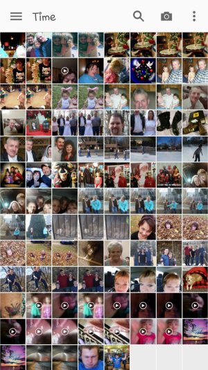

what about the time app. all my photos in Google are in folders. but time just keeps making more and more of the same photo.

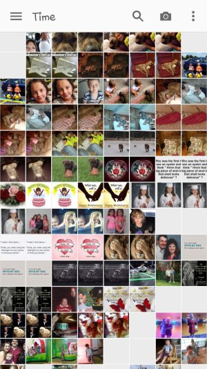

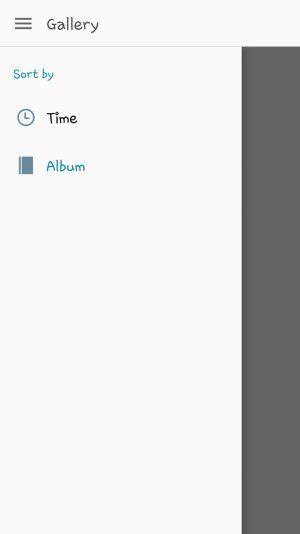

I don't think that's an actual folder -- I think it's just a sorting option, as I had mentioned before. What app are you in that shows this Time option? Is it the stock Gallery app, or the Google Photos app?

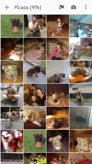

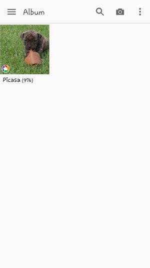

when I open gallery it has my Picasa albums and clicking the 3 lines on top, puts me into the time folder. yes, I started a new thread so I could attach the screen shot. that's is what I was told i needed to do. when I posted the new thread, I attached 4 shots at each step, but only the last one was there.
Just to confirm -- the name of the app you're opening is Gallery, correct? I don't think you can get rid of the Time view, because that's just a sorting option. It's not a separate folder.
Getting back to the other issue of duplicate photos -- pick a pair of those duplicated photos, and see if neither of them allow you to delete, or if only one of them allows you to delete. If only one of them allows you to delete, that means that's the one that's saved locally to the phone. The one you can't delete is the one that's in the cloud.
The Time feature in Samsung galleries isn't actually a doubling of the picture. It's a different view. The gallery can be viewed as Time, Albums, and depending on the version of the app, there are also Stories, Locations, etc.
The Time feature simply shows all the pictures in chronological order of taking/download to phone. It's not a doubling of the photos.
You say that it is not doubling the photos, is just a different way to view them. If you look at the screen shot you can see that alot of the photos are doubled. Now some are tripled. There are going on 3000 now. The option in the drop window for these are, a sideshow. Or details. If I hold down on a photo that group all get a box on it to check. I did that and then there was the option to delete, but it says that they are unsupported files. That just happened a couple hours ago, so that is something different. I think if I put this in the wrong spot. If it is can you please share it with b.diddy, thank you

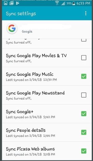

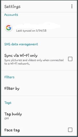

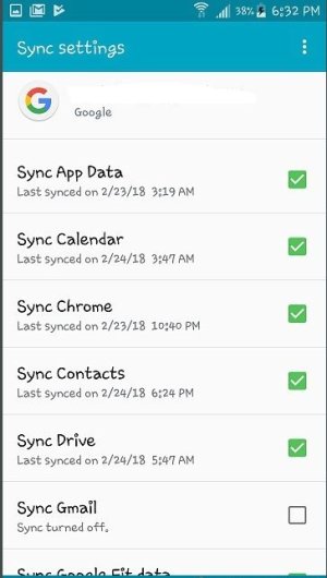

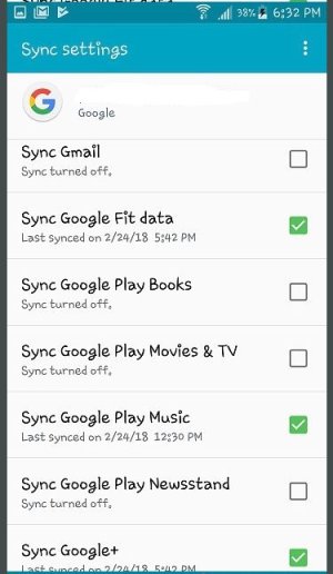

I'd like to figure out if we can turn off the syncing of your cloud photos (Picasa/Google Photos) to your stock Gallery app. Go to your System Settings, tap Accounts, then Google, and show us a screenshot of what sync items show up there. (You might have to take two screenshots if you have to scroll down to see the whole list.) Also select your Samsung account and show us a screenshot of those sync items. In case you need a refresher on how to attach images to a post, see this: http://forums.androidcentral.com/ge...ide-how-post-screenshots-android-central.html. It works best if you use the main forum site on your desktop browser, not the mobile Android Central app.
yes. it does give me an option to delete photos in the time rime part, but when I click on the duplicates it says they are unsupported files and doesn't do anything. but I can share to .....messenger, upload to Google photo save to drive, android beam or Google plus. which one will get to my account with you guys.

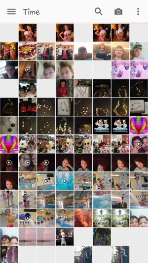

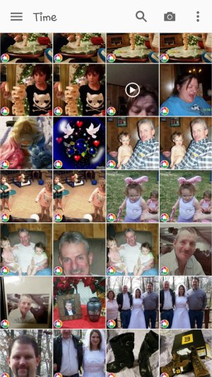

b.diddy chanchan05 there are a lot of these and I don't know how to make small. But I inserted image cause I don't see where to insert an attachment. I inserted them, I first tapped on Gallery and it opened up to the one thing saying Picassa and tapped on it to show how those pictures are. then I tapped the 3 lines and showed you the options of albums and time, the ones after that are the time photos and they just keep getting more and more, there are over 2 thousand so I didn't get them all.View attachment 279709View attachment 279710View attachment 279711View attachment 279712 and I also uploaded screen shots of what is synced.

these didn't show up like I intended them to but hopefully by my description of events, you can figure it out. Also, the 3 that are there with Picasa on the top, are not doubled on my phone. I think I clicked the button more than once cause I expected to see something appear after clicking the 1st time. I hope you can make some kind of sense out of this. Ya'll help with pc,s also? lol
Ok, THAT'S what I wanted to see. In the Sync Settings, uncheck Sync Picasa Web Albums. After you do that, if you still see the duplicates, then clear the app cache/data again from the Gallery app as previously described. Now see if the duplicates are still there.
