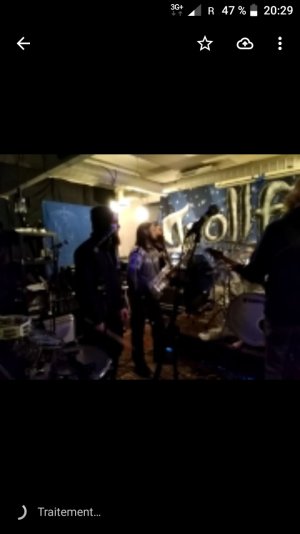

Hey, its now been a few month that when I take several pictures with my Android phone (front and rear camera) the first one are ok but then the others are constatly loading in the photo app. They are super blurry and a logo in the left bottom corner says "treating". I have to turn my phone off and on to finally see the picture and the quality is not as good as the ones that donnt get stuck like this.
My phone, camera app and photo app are up to date (8.1.0)
Since the first time this happened 4 or 5 months ago I was never again able to take several photos in a row without this issue...
Can someone help please?
No mods whatsoever and my phone is a Nokia 6, TA-1033
I took a screenshot of what happens.

Try a new SD card. Google the speed definitions. Make sure it's fast enough. Good luck.
I agree, the card may be the problem. It might just be corrupt or otherwise faulty. It's easy to narrow the issue down -- change the default save location temporarily to Internal Storage and see if the problem persists. If it doesn't, then get a new SD card.

Just to be sure, check to see if the Camera is actually set to save photos to Internal Storage in its settings. If it's still set to save to SD by default, and if the SD is faulty, that might be part of the reason why you're seeing this issue.
