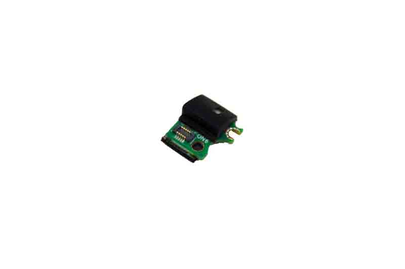

The side mic looks like it is part of the logic board, so I don't think one can be replaced without the other.
The "Fix it" article here shows how to replace the upper mic (with pics). It apparently plugs into a socket.
