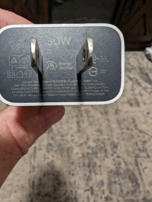

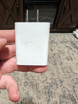

Ill show pictures of my stock 30w PD google charger specs
You will see at different voltage it will give different watts 9v/ 11v/ 16v /20v etc..

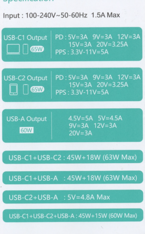

I purchased a 65W GaN USB-C (PPS) Charger. It has 3 ports USB-C1, USB-C2, USB-A.
Below are the specs that I do not understand?????
Can someone explain what these specs mean.
I am assuming for example if you connect USB-C2 and connect UAB-A on the device you simply a 5V charger????
So different connection combinations give different charging specs.
Is a Pixel 7 compatible with GaN chargers?

I'm not familiar with gaN charger but I would stick with recommend name brand or stock 30w PD charger
Gallium nitride chargers are more energy efficient and compact, so they generally charge faster without as much heat generation (in the charger, that is): https://www.belkin.com/products/product-resources/gan-chargers/. I have a couple of GaN chargers, and they work great for my Pixel 7 Pro, Chromebooks, and everything else. But as mustang7757 says, I would stick with known brands to be safe. Apart from the main manufacturers like Google and Samsung, other good brands include Anker and Belkin. Chinese brands with odd names in all-caps are a bit more suspicious, but Nekteck and UGREEN seem to be reviewed pretty well (I have a Nekteck charger that works great).
