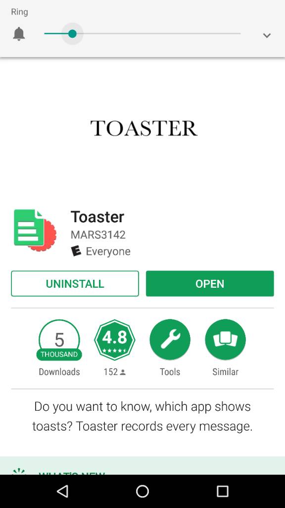

I'm having the same issue on on my Pixel XL. Can you post a link to the correct Toaster app in the playstore?
I can't post a link, so will try to attach a screenshot.
