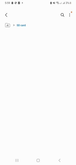

How long does reflashing take? Would it erase everything in my phone? Also the sdcard part in my files manager is not showing up. It just freezes, this is it. Someone please help, I don't know what to do, I really need my phone.

In case something on the SD card is corrupt, have you already tried unmounting the card and removing it? The Unmount option should be in the Settings>Storage menu. If there's no option for unmounting, you should be able to simply remove the card.

I can help you flash the stock firmware and there is a way to flash without erasing the device but like anything make back ups with Google account, photos, use Samsung cloud back up on the device and use smart switch on PC back up that way you can restore your stuff anytime, even Over The Air (OTA) can change home screen set-up,custom ringtones so back everything up.
If you still have the issue with no SD card I think you should try a factory reset before flashing.
