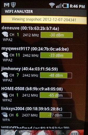

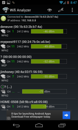

Thanks for the suggestion. Below are screenshots from that app on two devices, the Sidekick 4G and the Nexus 4.
(I never got around to installing a screencap app on the SK, so I just took a photo of it.)
On the SK I get about -30 dBm, on the N4 about -40 to -50.
Other nearby access points show a similar difference.
The other ways of looking at the data in that app show about the same thing.
The N4 seems to show more "?" items - I'm not sure what that indicates.

(Does the "Screenshot" feature in Wifi Analyzer actually take screenshots or does it just capture the displayed data? I tried to Send the results but it seems to just send xml.)

I am sitting in my kitchen. My Wi-Fi router is in the basement, about 8 - 10 feet from me on the diagonal with (of course) a floor between us.
Using Wi-Fi Analyzer, I see about a 3 to 5 point spread between the signal strength on my N4 and on my recently retired HTC Evo 4G, with the N4 mostly being the weaker unit although they sometimes flip and the N4 comes out on top briefly; both hover in the -59 to -68 area. Results are the same for both my own network and the two neighbors who are within range (but in the -90's).
