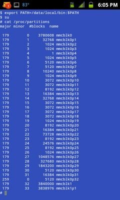

I was looking at the partition list I posted earlier is it possible that numbers 13,21 and 31 are all the same and its not writing it correctly?

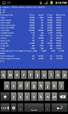

could this be doing something to the recovery /dev/block/mmcblk0p30 /LGE_RC? could that stand for LGE_Recovery Console?
