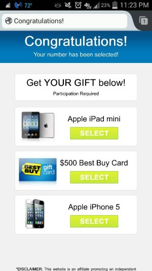

I've been having new ones now..I guess but now it's not taking me to the app store it's just opening the browser and saying congrats..I'll just show you a screenshot.. starts from this url... oops won't let me paste ... dangit why not.. I'll figure it out later..

I've cleaned my cookies now(which I honestly didn't do before) I think this one was a hijacker virus.. infact the infamous Sethavazutracking jerk... usually found on pc.. I cleared my cookies well see what happens..my phones not a pc so all the other crap they asked if you to do does not apply..

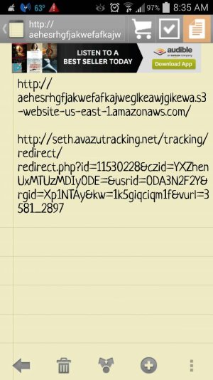

These are the hijacker links.. hope you guys dont get them too.. I'd clear your cookies at least.. I have a lot of crap invested in my history and everything else so until I do some manual clean up I can't delete anything else.. let you know if it works.. for those just reading I never had the music paradise like everyone else..
