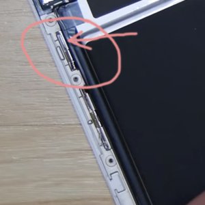

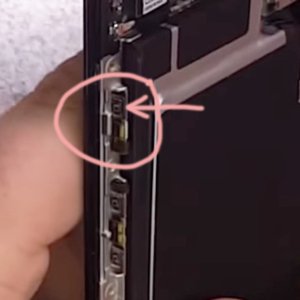

Just to add one more data point for any future owners who are worried about this, here are 2 captures from the teardown videos that prove out the location of the microswitch - way up at the top, which explains the crappy (yet normal) button feel.
This is a little more straight on, of the microswitch itself.
This is a top-down view indicating the location of the microswitch in relation the overall shape of the button.
